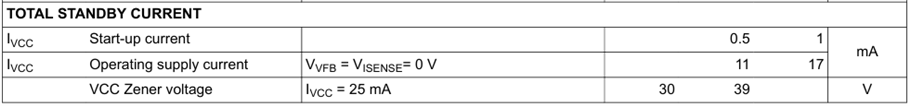

when designing a flyback converter using the UC3842 IC with an input range of 200V to 1000V and a 24V output
would it be appropriate to use a 280kohm start-up resistor?
according to the datasheet, the maximum start-up current is 1 mA.
at the low end of the input voltage 200V, the current through the resistor seems to be close to this maximum value.
is it ok?
