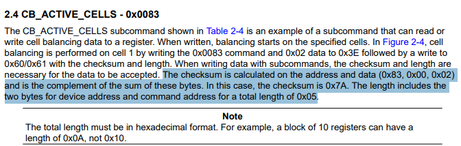

  • Certain subcommands write data to a register and must be followed by a write to 0x60/0x61 with the checksum and length. This only applies to the CB_ACTIVE_CELLS, PROG_TIMER, PROT_RECOVERY, and SECURITY_KEYS subcommands.
    More detail on calculation of checksum and length can be found in the BQ7690x Software Development Guide
    Section 5 Simple Code Examples in theBQ7690x Software Development Guide also gives an example using the DataRAM_Write function that shows the calculation of checksum and length.

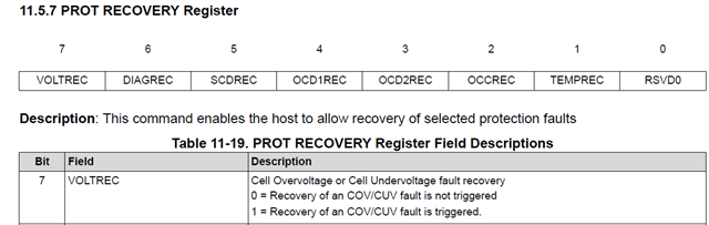

  • So I can see that 0x80 is the value for the PROT_RECOVERY register, but the VOLTREC bit is still Green (Bit Low)which corresponds to 0x00. So there is a discrepancy between them. It seems like there is some error between writing the register value and what BQStudio reads back and displays as low.
    Could you check for any errors under the Errors tab why trying to write VOLTREC=1 in the PROT_RECOVERY register? Do the Commands or Command Sequency provide any useful information during this?
    Also I suggest clicking the Scan button in the top right corner to allow the values to continuously update. Please let me know if the PROT_RECOVERY register value discrepancy persists after this with no sign of any errors.
  • I do not see any errors when I write the PROT_RECOVERY register in Battery Management Studio.  The status bar says "Operation executed successfully" when I write 0x80. I enabled Scan mode but the bit stays green.  Are these supposed to be self-clearing bits?  The register description indicates that recovery of the fault is triggered, but maybe that is a temporary condition?  Regardless, the CUV status remains uncleared.

  • The following actions resolved this issue:
    After digging more, there is a bqStudio issue.  If you type the value into the PROT_RECOVERY line in the Registers page and hit return, it doesn’t seem to get executed properly (even though it says it did).
     If you do the full sequence using the Command Sequence tab (writing 0x00 9B 80 to 0x3E, then writing 0xE4 0x05 to 0x60), then it works ok.
     The bits do appear to be self-clearing, I don’t see VOLTREC turn red in bqStudio.
    Also – the FET Options[PROTRCVR] bit does need to be set, even in FULLACCESS, to use manual recovery.  TRM needs to be updated.
