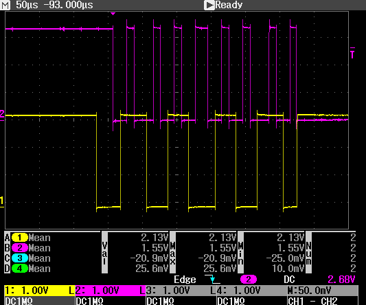

  • I ask because I am, not even seeing an ACK to my 0xAA start on the I2C bus between my micro (MSP430G2553IRHB32R) and the gauge (BQ27Z758YAHR).  The only thing on the SDA / SCL lines besides these two parts are a pair of 10K pullups.

  • Ok. Should I assume the default FW should ACK an I2C start to addr 0xAA (0x55 + R/W bit).  Any suggestions for why it wouldn't?
    Make sure you have your comm lines pulled up to a 3.3V steady source. Are you using the EV2400?
    Jonny.
  • I am using pullups (10K) to the VDD of the BQ27Z758.  I am not using the EV2400 as I cannot access the relevant signals internal to my system.  My only connection to the BQ27Z758 is via an embedded MSP430G2553IRHB32R which I am bit banging GPIO to the fuel gauge's I2C pins.  I have got the BQ27Z758 to ACK the address and even readout some registers - albeit with some unusual responses.  It appears the necessary action to gain I2C life was to  remove the connection from the /ENAB pin to GND.  Does that make any sense?  It would seem from the datasheet pin description and all the reference circuits that one should explicitly tie /ENAB to GND, so is it possible that pulling it high (or allowing it to float) is actually needed to achieve communication?
    Can you elaborate on the function and ways to manage the /ENAB signal?
    The ENAB pin should not have an effect on the comms. ENAB can be directly tied to gnd or can be left floating. The ENAB pin is only used to wake the device from low power modes.
