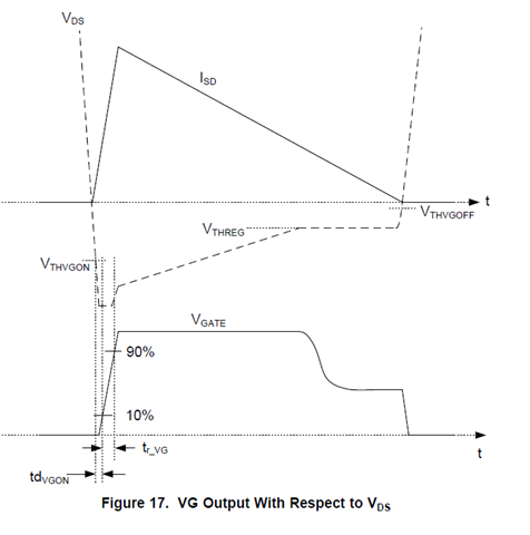

I am considering the UCC24612-2.
This IC has a TON BLANK non-detection time of 540 ns (for -2) to prevent ringing from reaching the off threshold and causing the gate to turn off prematurely.
At what point does this counting start?
There is a delay of td VGON (170 ns) and tr_VG (32 ns) before the gate rises. Does it start after this has elapsed?
Or does it start from the moment VDS reverses (the moment current starts to flow)?
  • Hello Kaji-san,
    That is a good question.
    Figure 19 implies that the TON Blanking timer starts at the same instant that the VG output is driven (starting from 0V, not at 10% rise point).
    This further implies that the turn-on delay td_VGON (170ns) has already elapsed since the moment that Vds has crossed below the V_THVGON turn-on threshold of -0.24V.
    I don't think that tr_VG (32ns rise time) is involved with this timing.
    This is my interpretation of the datasheet information.
    I will check with the Design Engineering team to verify if my interpretation is correct, but it may be a day or two before I get a reply.
