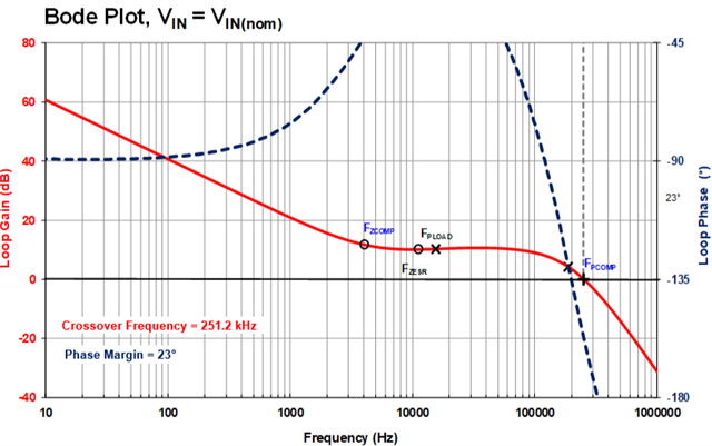

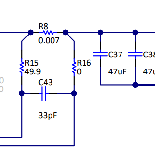

Dear TI master,

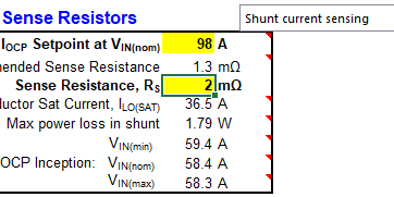

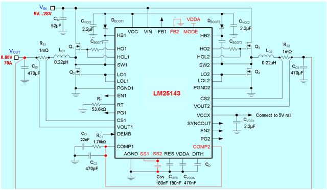

by the quickstart excel, have made the 2-phases single output
Fsw = 410kHz, crossover freq = 41kHz
Inductor = 0.22 uH
Rshunt = 0.002 ohm

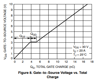

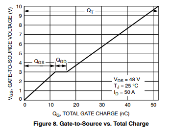

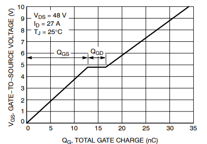

FET = NVMFS5H663NTT1G and NVMS5C628NLT1G

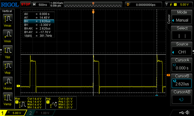

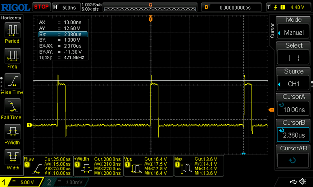

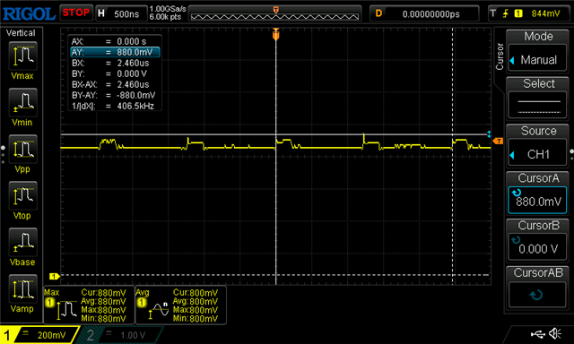

but the output result current not enought as designed
the below listed the Vin and Iout limited, when loading over this current, Vout <=0.871
Hiccup mode enabled
(V) Voltage (A) Current Limit (Vout >0.871)
12 32
16 25
20 19
24 13
 Hiccup mode disabled
(V) Voltage (A) Current Limit (Vout >0.871) (A) Max. Current (V) Vout @ Max. Current
12 41 42.3 0.798
16 36 38.1 0.707
20 29 33.7 0.62
24 14 33.2 0.608

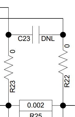

Attached my schematic for reference
Any problem affected the current can't to achieve to >60ANIRHD4PEVB-2_SCH_20250822.pdf
