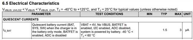

Customer would like to further reduce the power consumption. Do they need to intentionally set some register to achieve below quiescent current? Like turn off ADC.
Hi Kailun,
Yes the above spec is when the ADC is disabled. Also if using an EVM for evaluation, make sure all jumpers are disconnected as well.
