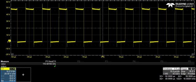

I am designing a boost circuit from 24V to 48V, output current is 5A. I test the SW and find it having a little overshoot. the waveform below.

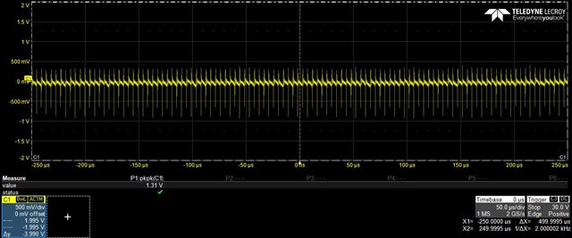

I also test the ripple, it is also a little bigger, waveform below.

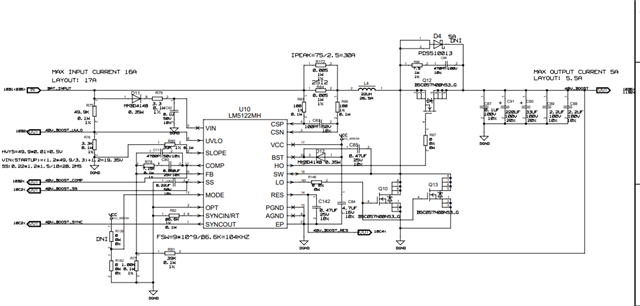

The schematic is below. Could you please help give some suggestion for improving them? Thanks in advance.

    To reduce the switch node overshoot, the first step would be to increase the gate resistance (R87, R146). Adding resistance in the range 1 Ohm - 10 Ohm can already reduce switch node overshoots significantly.
    The next step would be adjusting the RC snubber to increase the filtering effect.
    If none of these solutions can reduce the overshoot enough, the final step would be to review the layout and find optimizations here.
    Regarding output voltage ripple, low ESR ceramic capacitors are best for filtering switching noise.
    However, adding more ceramic capacitors may also require a layout change to add the required footprints.
