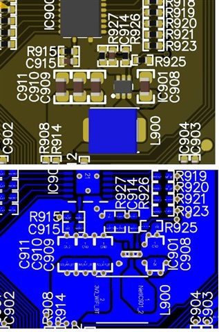

  • Hi Zakir,
    Tried 10K and 2.2K, it didn't make improvement.
    Please find our layout below for your information. The upper one is 3D and lower one is 2D view.
    Thansk,
    Paul

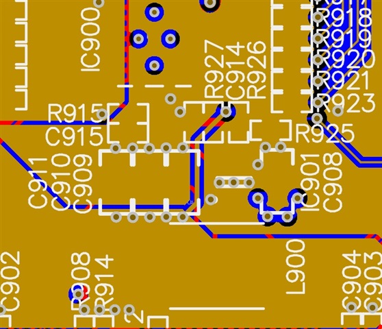

  • Hi Paul,
    With the layout almost everything is visible except the Vias or internal signal layers. I want to see the GND of feedback divider and also the trace of VOUT signal that connects the feedback divider. Can you share one more screenshot showing these things? I appreciate for being patient and bearing with us.
    Zakir

  • Hi Zakir,
    Please find the enclosed pic for the GND and the trace of VOUT and divider.
    Paul

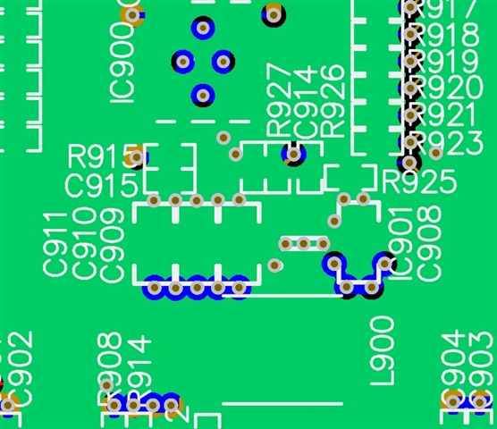

  • Ground layer
