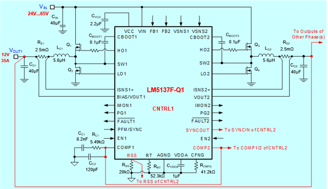

    Please refer to the following QuickStart file for a 3-phase implementation example: LM5137-Q1_quickstart_calculator_revB6.xlsm. Please note that this is a basic design and hasn’t been fully optimized.
    A 3-phase design is largely similar to a 4-phase implementation. The primary difference is that the fourth phase is disabled. In a multiphase design, one controller must be designated as the master, with the remaining controllers operating as slaves.
    Check the following schematic diagram for reference -
    Refer to the notes within the QuickStart file for detailed implementation guidance.
