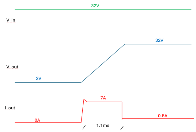

we are using the TPS2H160 in the following conditions:
  • OUT1 and OUT2 connected in parallel
  • output load = 160 uF
  • Vbatt = 32V
  • repetition = 1 per vehicle key cycle
  • lifetime = 29251 key cycles
  • max ambient temperature = 85 °C
  • current limiting resistor = 560 ohm
Could you please let us know if you see any concerns with this usage scenario?
