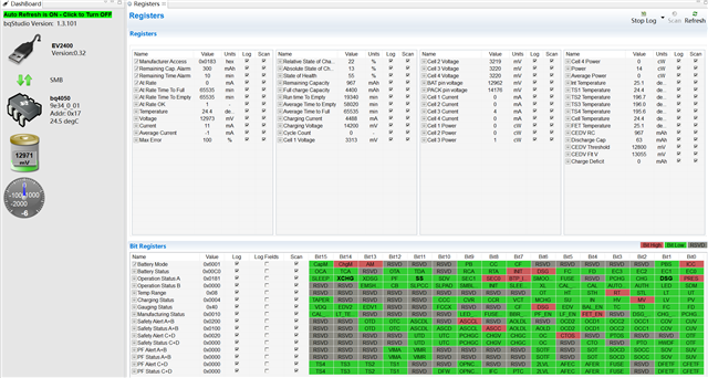

Connect our PCB to the load, the current is 0 mA, the current charging threshold is 50 mA, and the current discharge threshold is set to 100 mA. The CHG is ON, and the DSG is OFF, why is the PCB charging and discharging mos driving abnormal ? The configuration and log files are as follows :

Our PCB is connected to the BUCK topology output controlled by BQ24610, and the status is displayed as follows : DSG and CHG status anomalies
