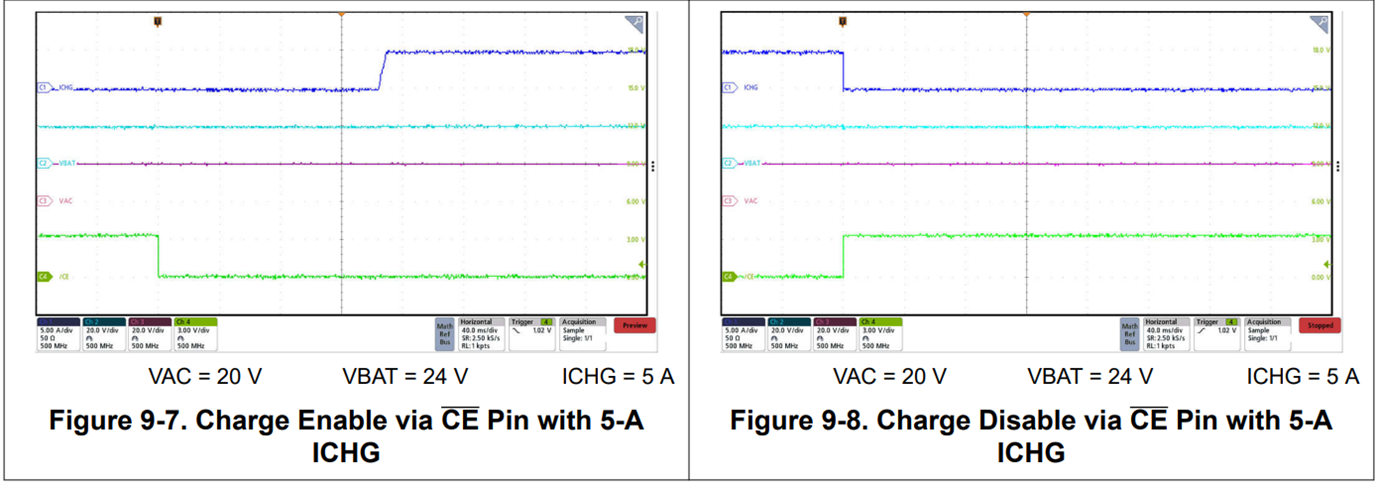

    I need to do charge and no charge with the switching frequency of 1kHz. Can I just toggle the Charge Enable Pin (CE) with frequency of 1kHz to achieve this
    Or is there any better efficient way to do this
  • Hi Abishek,
    What is the application of toggling the charge? Toggling the /CE pin should toggle the charge, but it may not achieve what you want.
    Michael

  • Hi Michael
    Yes. Based on the voltage and current values, the measurement is done externally. BQ25756E supply the pulsed current on 1kHz
    Whether using a external MOSFET at charging output to battery path is better approach or toggling the CE is better?
    Because The response time of toggling the CE with 1kHz in BQ25756E will affect the pulsed charging
    Please let know your suggestion on this
    Abishek V
  • Hi Abishek,
    These waveforms are taken from the datasheet. I am concerned about the delay of the /CE pin for this application. I don't think the toggling will work for impedance measurements.
    Adding a MOSFET to the output battery path may be better, but I would also be concerned about the device continuing to charge up the output capacitors to the full charge, terminating, and taking a while to start back up charging.
    Michael
