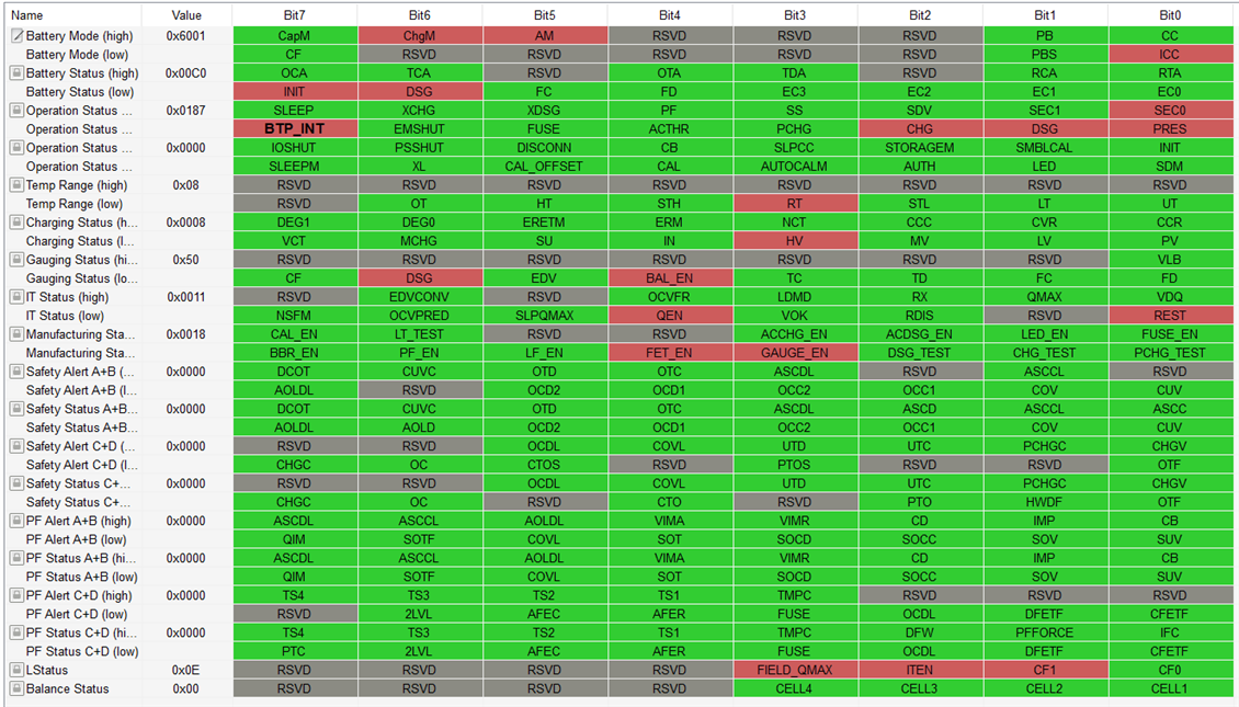

  • Gauging is enabled - ManufacturingStatus[GAUGE_EN] = 1
  • Balancing is enabled - GaugingStatus[BAL_EN] = 1
  • There are no SafetyAlerts, SafetyStatus, or Permanent Failures
  • A Field Learning Cycle has been performed - LSTATUS[FIELD_QMAX] = 1 and Gas Gauging -> State -> Update Status = 0xE

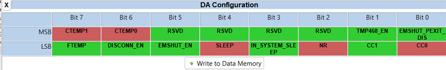

  • Sleep is enabled - DA Configuration[SLEEP] = 1

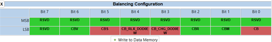

  • Cell Balancing in Sleep is Enabled - Balancing Configuration[CB] = 1 and Balancing Configuration[CBS] = 1
  • The fuel gauge has taken at least two OCV readings and updated the cell balancing time - Cell 1 Bal Time = 0, Cell 2 Bal Time = 1998s

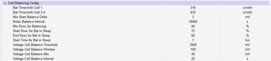

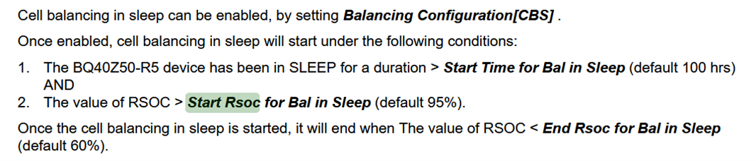

  • The RSOC of the battery pack is at 90% which is above Start Rsoc for Bal in Sleep. I have set Start Time for Bal in Sleep artificially low in this screenshot to 1h to force it to happen more quickly just for testing (it is typically at 100h).
