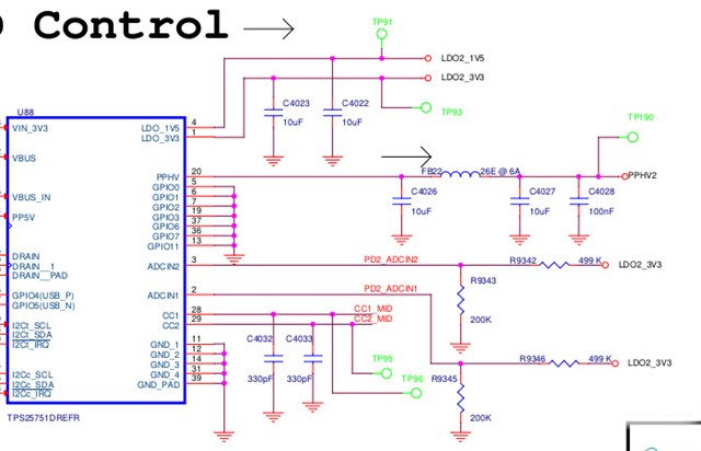

  • Hi
    Thanks for your prompt response,Here's the information you have asked for,
    If you do not load the patch, then the device will operate based upon the dead-battery configuration defined by ADCINx.  Which configuration are you using? AlwaysEnableSink or NegotiateHighVoltage?  What minimum voltage do you require in the no-battery operation?
     I have attached the snap from the schematic for your reference. The minimum voltage required in no-battery operation is around 5V.

    The resistor divider on ADCIN2 is 200k/(200k+499K) = 0.286 and results in decode value of '4'. https://www.ti.com/lit/ds/symlink/tps25751.pdf#page=39
    This is not a valid decode value for ADCIN2.  https://www.ti.com/lit/ds/symlink/tps25751.pdf#page=45
    Can you change the ADCIN1 and ADCIN2 configuration for AlwaysEnableSink with the appropriate I2C address for your application?
    Also, can you monitor I2Cc on the PD controller?
    Thanks and Regards,
    Chris
  • Hi  ,
    Apologies for delayed response,
    -- We have made changes in the HW and configured both the pins as per highlighted values from the Table 8.2
    The slave address is configured as 0x21 which is correct as per the Table 8-6 and Table 8-5.

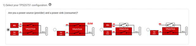

    Still we are having the same issue and the system is going down once it reaches for patch loading. Can you point me if I am missing any configuration in GUI tool to generate binary?

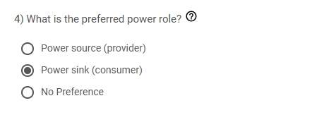

    Can you confirm the preferred power role? If the power role preference is provider, then the PD will request a power role swap (even though there is no battery).
    Chris
  • Hi Chris,
    Yes the preferred power role is set to Power sink.
