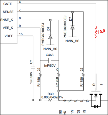

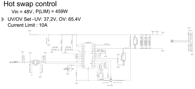

Could you review the schematic?
Thanks.
Thanks for reaching out.
Please place a 10Ω series resistance between the controller gate pin and MOSFET gate pin.
Otherwise, the schematic looks good.
