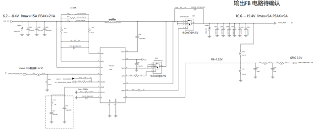

We are currently designing a system using the TPS43061 and would like to request your assistance in reviewing our schematic to ensure correct implementation and avoid any potential issues.
The schematic is attached for your reference.

    The worst case scenario for maximum inductor current would be 6.2V VIN, 19.4V VOUT and 9A load, which would result in ~30A inductor current.
    Please double check if this case is possible, as it would require smaller sense resistance and a higher inductor current rating.
    Aside from this, the design looks good to me.
    Please let me know if any additional questions come up.
