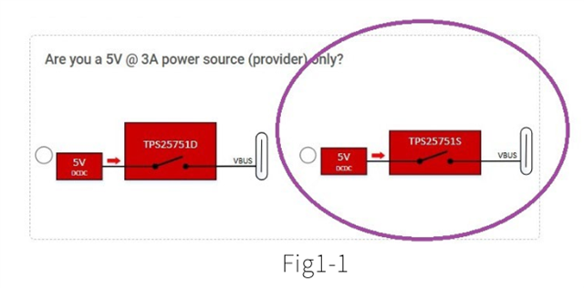

✓ In the USBPD Application Customization for TPS25751, it is possible to set Power Source only as shown in Fig.1-1.
But in the above specification of Power role, there is no description of “Source”.
Does this mean the operation has a different meaning?

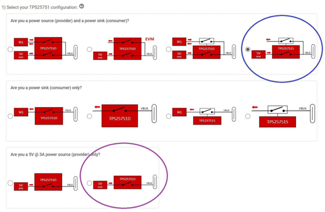

Q2. About candidate selection with ◎ mark in TPS25751S setting
・Our end device is a printer. The communication port is being replaced from USB Type-B to Type-C, and it is assumed to supply power to the upstream host.
However, if a notebook PC (that does not require power supply) is connected, the upstream side may supply 5 V / 500 mA to VBUS.
In such a configuration, should we select the blue circle or the purple circle?
・If selecting the blue circle, sink current is not particularly needed, so we do not attach an external FET.
In this case, must the circuit configuration be exactly like this?
・If selecting the purple circle, PDC will be Source only.
In that case, if the upstream device is also Source only, won’t the two Sources collide and cause a problem?

    The TPS25751 can act as a DRP or a sink only device up to 100W. If the TPS25751 is a source only configuration the maximum power is 15W (5V/3A).
    My understanding is that the printer sources power to any sink that gets connected. A host device, such as a PC notebook, gets attached as a source. If I understanding is correct, then the printer will have to perform a power role swap to sink when the source is connected. The printer will need to be a DRP to be able to swap between sink and source. Additionally, the source only configuration only allows for 15V maximum power.  With all of this in mind I would select the blue circle for your application.
    If current isn't needed over the sink path, then I agree with removing the external FET. I recommend setting a sink PDO for the printer to 5V/0A. This will allow for the controller to accept the power negation contract between the source and the printer, but the source will not affect the printer.
    Is this interpretation correct?
    Yes, your understanding is correct.
