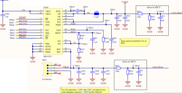

I have a setup with the following schematics:
VIN is the Vbus of an USB-C Port to which the device is the peripheral/device, never the host.
Now what I am trying to do, is to disconnect the Battery (via I2C host) from the device for end of line measurements, where we want to see device consumption via Vbus (since the device is already assembled and the USB is the only connection to the outside). From my understanding, disabling charging via CE = high or CHG_CONFIG(REG01[4:5]) = 0 and disabling the BATFET via BATFET_Disable (REG07[5]) should do the trick (watchdog is also disabled). This seems to have the desired effect with a Battery that is not fully charged, but if I connect a battery with a voltage around VREG, I get additional consumption at Vbus of around 22mA and a load change on Vsys is no longer 1:1 reflected in that input current.
What could be happening there and how do I prevent it?

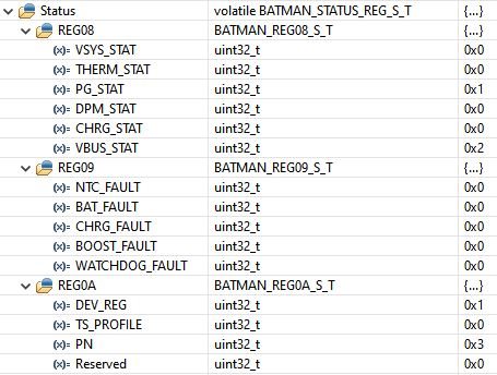

  • Like I said the only difference in the environment is VBAT.
    1. Iloss = 1.4mA (Ibat is 0mA in both cases)
    1) VBUS = 4.7V IVBUS= 7,8mA, VBAT = 3.6V IBAT=0mA, VSYS= 4.19V, ISYS= 6,4mA
    2) Settings:

    Status:

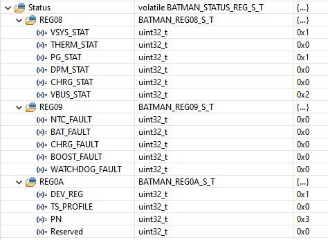

    2. Iloss = 23.4mA
    1) VBUS = 4.7V IVBUS= 31,2mA, VBAT = 3.8V IBAT=0mA, VSYS= 4.19V, ISYS= 6,4mA
    2)Settings:

    Status:
    So the effect seems to be down to VSYSY_STAT being in VSYSMIN regulation or not. But I don't understand how the regulation can be different depending von VBAT if BATFET is disabled (so "shipping mode").

  • Hi Oliver,
    It looks like Battery voltage is having an impact on input current, regardless of the BATFET being disabled. Can you try a couple of items to better understand the behavior:
    - It appears VBAT has a direct connection to the MCU through a pair of resistors. Can you depopulate R612 and rerun the test? Sometimes unexpected power-paths through the MCU or SYS signals can have an unexpected impact on device behavior.
    - Can you try this test with your load disconnected? This is to try to isolate behavior to the BQ Charger to ensure there isn't another factor that might be impacting current consumption.
    - Can you provide any waveforms of VIN, VSYS, VSW, and VBAT under the two different conditions to contrast the device behavior?
    Juan Ospina
