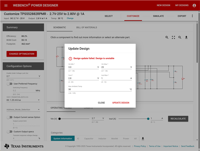

We are trying to use the TPS552882RPMR device with 2.8V/1A output for input range of 3.0V to 25V and Webench is saying the design is unstable.
Also - why is the part spec'd at 2.7V operation, but will not power up at 2.7V? If the UVLP requires 3.0V, then the bullet list should use 3.0V....
We have the design up and running, but we're getting a ~6mA increase in input power consumption @ 3.0V input, with very light load?

  • Why does Webench still say design is unstable for input voltage 3.0V? See screen capture;
    (we take the original Webench design and change ONLY the input from 2.8V to 3.0V)
    As for the increase current consumption - we have previous revision board (with another vendor DCDC) and this revision, with TI DCDC, is consuming 6mA more than previous revision... we are concerned that due to the Webench issue, is the TI design (operating at 3.0V input) inefficient and resulting in the increased power consumption?
  • Hi Mark,
    Webench is sometimes useless when you type in not typical case. So please ignore this error and just see real bench test result.
    And the 6mA is compared with competitor, so do they share same solution? And what's MODE pin resistor? Recommend to use 24.9k to configure PFM mode, so that the current consuming can be lower at light load.

  • Hi Mark,
    Webench is a tool designed and maintained by another team in TI. We cannot control the result in the tool.
    But I need to say that TPS552882 is also start at 3V, 2.7V is shutdown voltage threshold.
