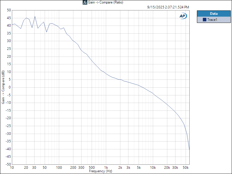

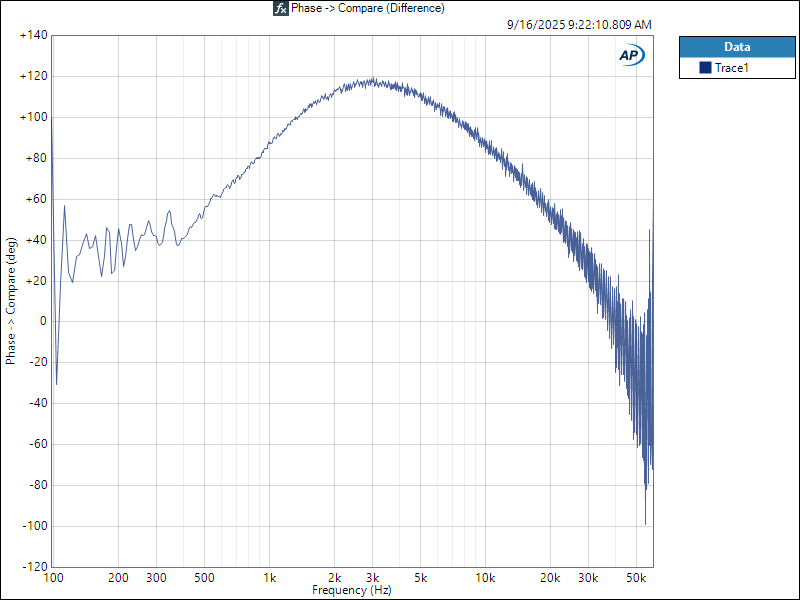

I have performed a Bode plot(attached) of a design based on TPS23754EVM_383 and I would like to know what the gain margin and phase margin is from these.
I am confused how to work this out because although my gain plot looks pretty good, my phase plot has more than 360 degrees phase shift, please advise where my -180 degrees is.
Please advise - I attach both plots.
