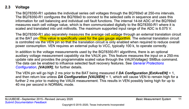

I'm configuring a BQ78350-R1 and have enabled VEXTAVG_EN. I'm looking for clarification on the Ext Cell Divider parameter.
Is this parameter essential for the gas gauge algorithm to function accurately? What are the potential consequences of setting an incorrect gain value for the external cell divider? Could this impact the State of Charge estimation?
Any insights would be greatly appreciated.
Thanks.
