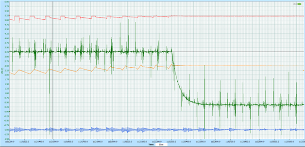

I'm troubleshooting a half bridge module that uses two UCC21750s. After a few minutes under load, the low side IC will assert the fault pin, stopping operation. On the control side, the fault and reset pins from both ICs are tied together, and this net is pulled up to 3.3v with a 1kOhm resistor. As part of troubleshooting, I've lifted the desat pin off the board and bridged it to the adjacent com pin, to disable the desat circuitry on the low side.
In spite of disabling the desat circuit, the fault pin still goes low after a few minutes. If I lift the low side IC's fault pin off the board, the circuit will operate under load indefinitely. In the scope image below, the green trace is the fault line (250mV/div), red is current through the device that's faulting (50A/div), yellow is the current out the midpoint of the bridge (25A/div), and blue is an unused probe. The timescale is 50us/div. The green probe was a standard 10x probe with a clip lead on it, in a fairly noisy environment. The packaging of the system means I can't use a spring clip or hold a probe in place, sadly.

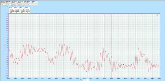

  • Sadly I'm a bit limited on the measurement equipment I have. The best measurement I can make at the moment is using a 200MHz isolated scope and a passive probe with a typical ground lead. With that, the peak slew rate I've measured is 357V/us with or without the 10pF capacitor (the probe itself has a 5.5pF input capacitance). The pk-pk voltage of the measurement is 1552v and the location is obviously in the vicinity of several high power connections, so it's a bit challenging to find a high speed probe that can be attached close to the board (i.e. no hand-holding) and supports the voltage necessary.
    The fast ringing appears to be in the range of 150kHz, which I don't have an explanation for yet. There's a slower speed square wave near 10kHz due to switching, and at the midpoint there's a single large transition again due to switching.
  • I was able to solder a BNC connector across the IC to reduce the noise picked up by the probe. The result was very similar, with a significant peak at 135kHz but not much beyond that.

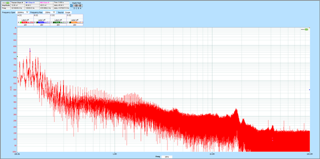

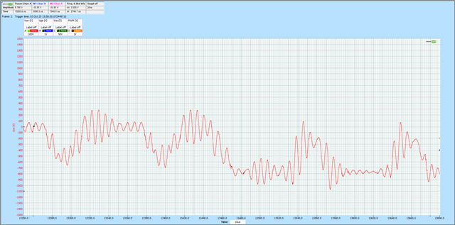

  • I have a waveform with and without the additional capacitor but I can't find any differences between them. I did find that adding the probe (with no 10pF capacitor) is sufficient to prevent the fault from occurring. It appears that whatever noise is causing this fault won't be visible with my oscilloscope.
    The previous measurement was taken with the capacitor installed and this one is without.
    This is a slightly different view. Using the scope to find the slew rate, I was able to locate a few portions of the signal in the 1e9 V/s range.
    The FFT shows some frequency components above 10MHz.

    Thanks for the additional captures -especially the FFT waveforms. Based on it, looks like there is high frequency high amplitude CM noise exists between GND and COM. If the high current path (DC-) and COM are separated in your system,
    1. is it possible to add Ferrite bead between them to isolate the high frequency noise getting into COM plane?
    2. Another option would be to understand the source of the high frequency noise and reduce it.
    3. As adding even a smaller few pF (probe) helps to remove the FLT behavior, is it a viable option in your system?
