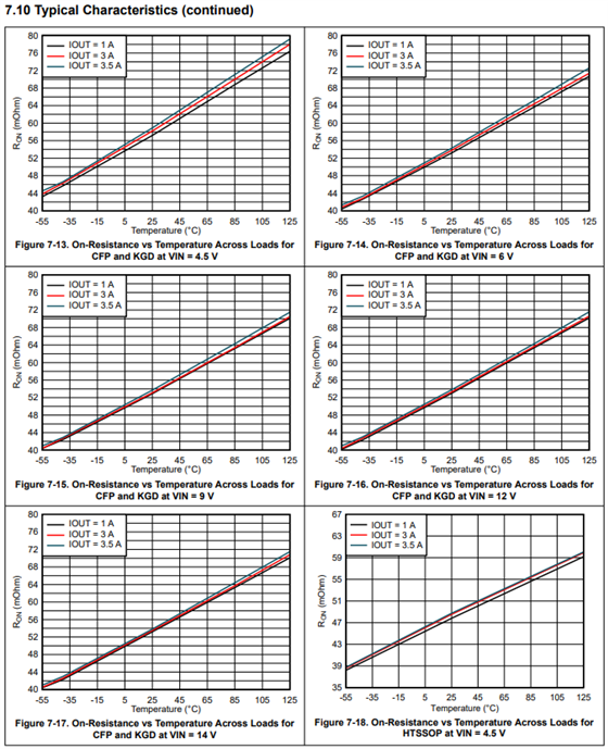

can you provide graphs showing the RDS of TPS7H2211-SP for every corresponding VIN & IIN for CFP package.
we want to use it for an application with really high precision and want to know how does the RDS changes with changing VIN & IIIN.
I have found this table but it is not enough to be able to know the exact RDS we will have at our operating conditions.

    Here are some graphs characterizing the R_ON across temperature using different IOUTs, found in the datasheet:
    Between the table sent and the graphs, there should be enough data to characterize the desired operating conditions.
