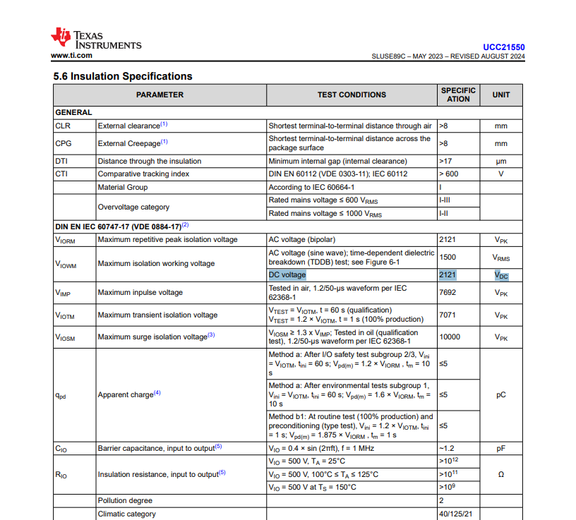

may i know the DC bus rating?

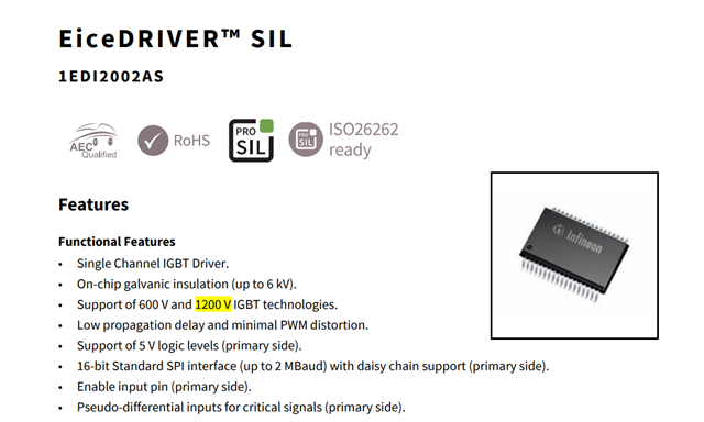

compare the infintion & TI

The max isolation working voltage (VBus rating) for DC is 2121V. It can be found in the "Insulation Specifications" section of the datasheet below:

Hi Alex,
I believe UCC21710-Q1 is our best match for 1EDI3031AS in terms of functionality. UCC21759-Q1 is another great option as well. I would recommend taking a look at these, and if you have any questions pertaining to either of these parts, feel free to open another thread under one of those parts.
Will
Hi Alex,
At the moment it seems like we do not have any direct comparison tables published for UCC21710 and 1EDI3031AS. However, feel free to use the cross-reference search tool on ti.com to compare them and find other good matches. Here is the link for the cross-reference search for 1EDI3031AS: https://www.ti.com/cross-reference-search/?singlePart=1EDI3031AS&p=1
In addition, the UCC21736-Q1 also appears to be a similar part to UCC21710-Q1 and UCC21759-Q1. Feel free to reach out on E2E under a thread with those parts listed to be paired with an expert on their part families.
