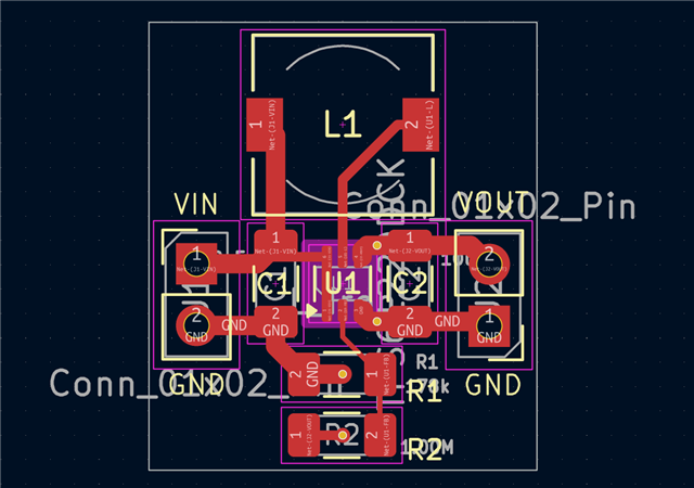

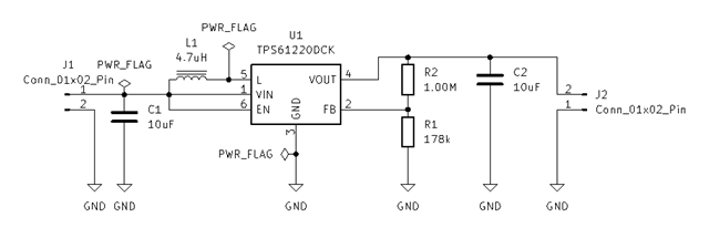

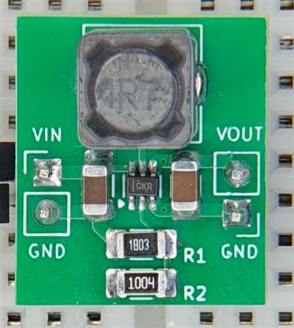

I'm seeing unexpected voltage output and fluctuating current input on the TPS61220 that I've soldered on my custom PCB (details can be found below). I would kindly request help to debug what might be going wrong in my setup.
Context
I'm planning to incorporate a TPS61220 voltage boost converter in my project. To learn how to design the final PCB, I've designed a small PCB to test out just the boost converter. I've modeled the design to the TPS61220EVM-319 evaluation model

  • R1 and R2 are swapped around compared to the TPS61220 datasheet.
  • I've used 180k instead of 178k resistor for R1 (in my datasheet)
  • Therefore, I expect: VOUT = VFB × (R2 + R1)/R1  = 0.5 x (1000+180)/180 ~ 3.28V
Schematic and PCB
Figure 1: Schematic

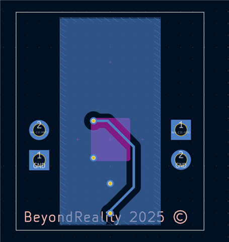

Figure 2: Front Layers PCB
Figure 3: Back Layers PCB
Figure 4: Photo of assembled PCB

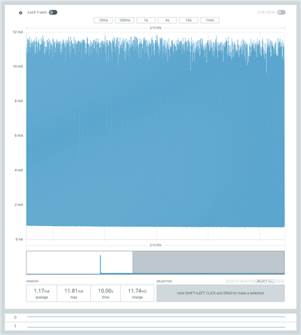

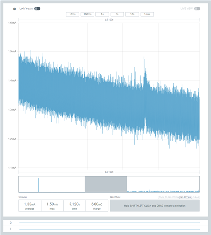

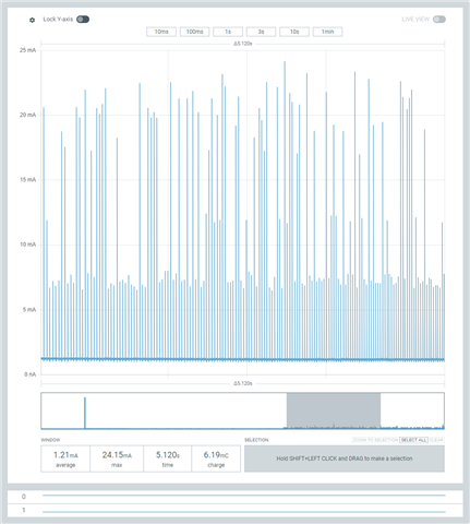

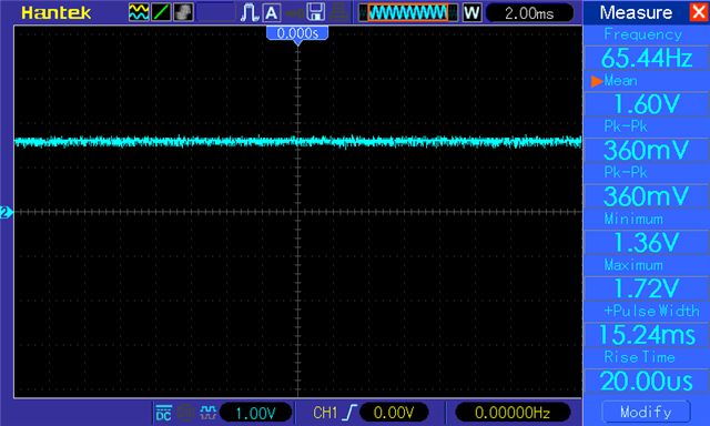

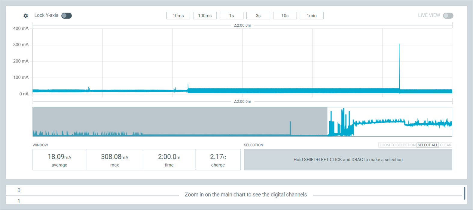

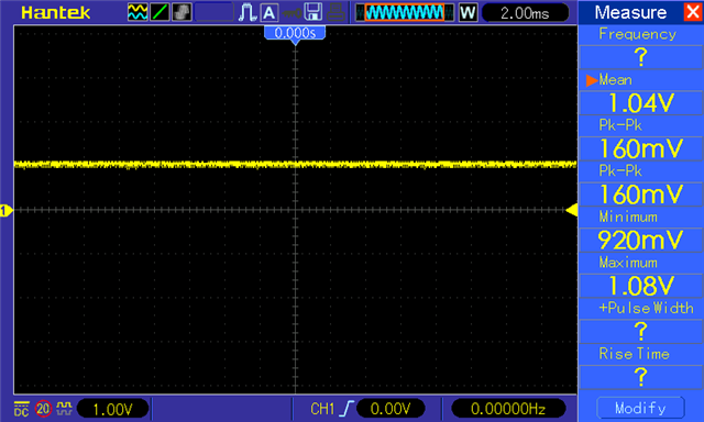

Measurements
Note: I don't have an Oscilloscope so the data collected below is from my Power Profile Kit II providing input voltage and current and a Multimeter measuring the output voltage.
Input voltage Output voltage Stable Power Consumption Screenshot
Figure 5: 1v.png
Figure 6: 1.5v.png
Figure 7: 2v - with load.png
Figure 8: 2v - without load.png
Figure 9: 3v.png
