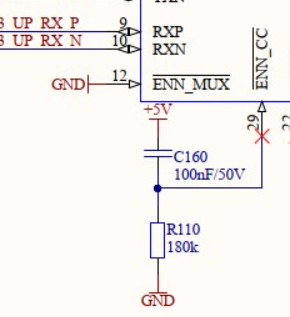

Attached is the schematic for the mux and the failure description.

    Looking at the schematic you sent over, I see that it looks like the CC pins are flipped, I.E CC1 of the 3220 is going to CC2 of the connector, and CC2 of the 3220 is going to CC1 of the connector. Is this intended? This might be affecting the flip orientation of the HD3SS3220.
    Does the HD3SS3220 enumerate properly, I.E USB3 enumerating over the type-C connection? I want to ensure the device with the HD3SS3220 is able to properly communicate over the connection.

    First i connected the CC1 to the CC1 of the Type C connector, but then it doesn´t work correctly... After I switched it to CC2 it was fine. It works like expected.

    Looking at the TX/RX pins in the schematic again, it does look like it is swapped, I.E TX1 of the HD3SS3220 goes to TX2 of the Type-C connector. That would explain why you had to swap the CC pins.

    I noticed this capacitor connecting to 5V on the ENN_CC pin. This is not needed, C160 can be removed. The ENN_CC pin can be directly connected to GND.
