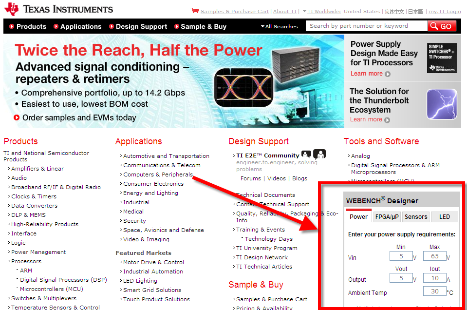

  • Hi Pavithra,
    There are ways that you could increase the current capability of the LM2576HV. However, these changes would probably disable protection features such current limit, short circuit protection etc.
    You would probably be better off starting with a part like the LM5116, of LM5088.  These controllers will be better able to handle the high voltage and current in your design.  These parts are enabled in Webench, which will give you a custom design based upon you parameters.
    To access webench go to
    WWW.ti.com
    Look in the bottom right hand corner and start your design.
    Marc
