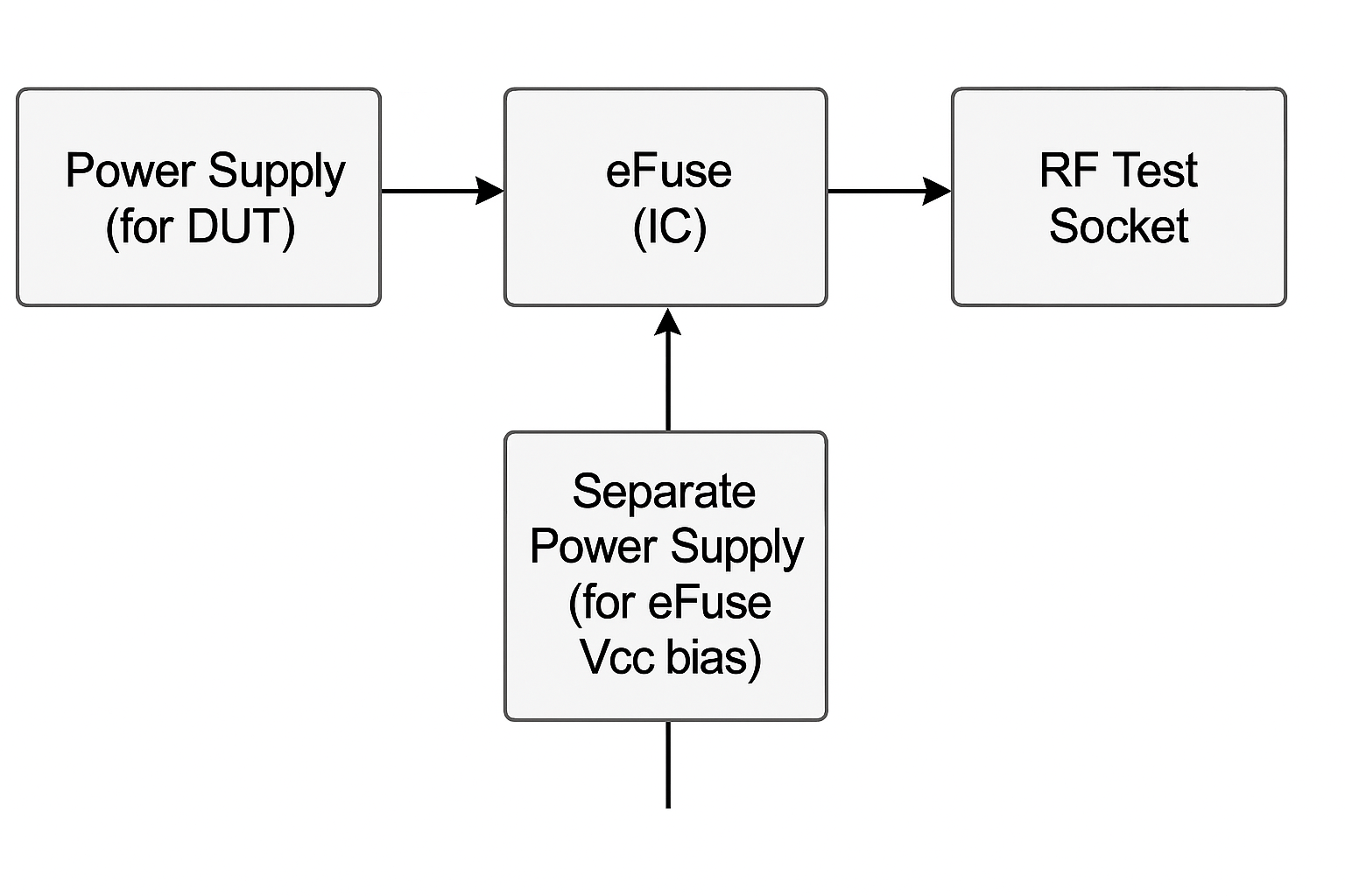

I'm considering using the TPS16851 to protect a semiconductor test socket. However, powering the TPS16851 from the same VDD that powers the DUT is causing issues with our leakage (DUT off measurement) measurements. Is it possible to power the TPS16851 from a separate VDD?
