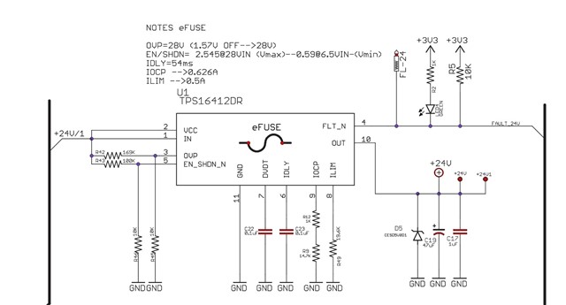

I am designing a power supply and I would like to use an eFuse to protect it, so I don’t need to replace a traditional fuse. I selected the TPS16412DRCR for this purpose.
Under normal operation the device works as expected. My input source is an AC/DC power supply rated at 24 V / 0.65 A.
  • When powered on, I can measure the 24 V at the output of the eFuse.
  • When I connect an electronic load at the output, the device behaves correctly: if I exceed the current limit threshold, the eFuse turns off the output, and once I reduce the load, the output voltage recovers as expected.
The problem occurs when I simulate a direct short circuit at the output. In this case:
  • The device is permanently damaged and ends up shorted between input, output, and GND.
  • Once this happens, the IC no longer operates.
  • I have desoldered and inspected the device and confirmed that it is physically burned.
  • If I replace the IC, the circuit works again, but the same failure happens when repeating the short-circuit test.

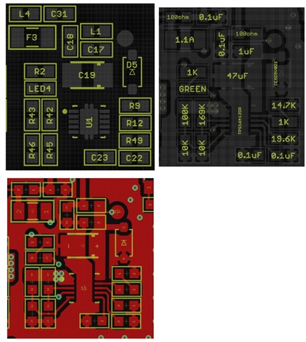

I have tried a few changes to improve the behavior:
  • Lowering the Rlim value to set a lower current limit.
  • Reducing the IDLY capacitor value.
Unfortunately, the result is always the same: the chip gets damaged during a short-circuit event.
It is important to mention that I have already used this same eFuse reference in a previous design, and it worked fine in that case. For this reason, I am not sure if the current issue could be related to the layout. The only significant difference compared to the previous design, besides the Rlimit value (since I set a different current threshold), is that in this new PCB I added multiple thermal vias to GND under the thermal pad.
Could someone please provide guidance on what might be wrong with my configuration or PCB implementation?
