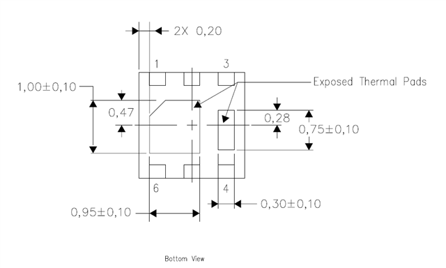

Could you provide pin3 with pin4 center to center dimension(mm)?
because I don't found this dimension in datasheet.

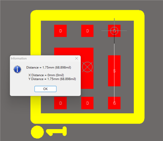

Thanks for your interest in TI FETs. Nominal center-to-center spacing from pin 3 to pin 4 is 2.00mm - 0.25mm = 1.75mm. Please let me know if you have any additional questions.
