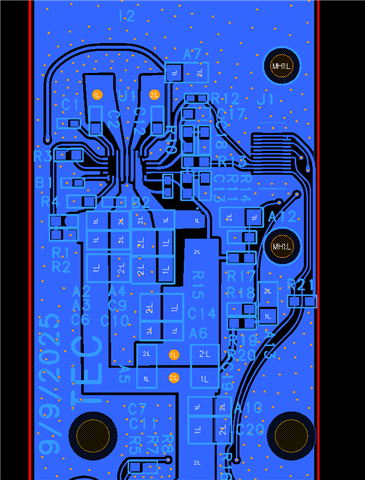

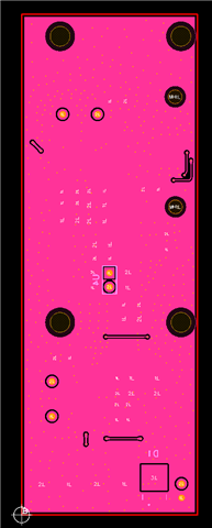

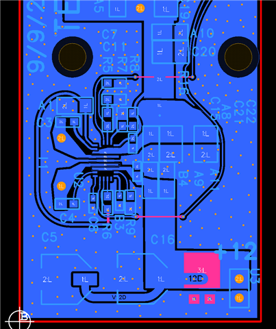

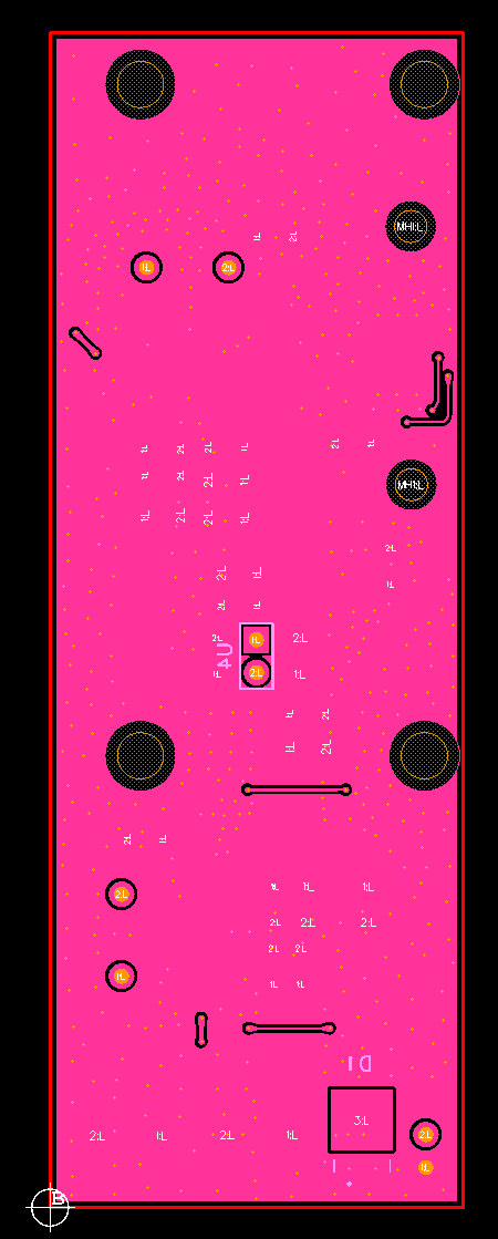

Part Number: TPS552892
12VDC to 5.5VDC. 4A.
I have an issue where the chip gets very hot with NO load.
I am using 100uf x 2 GRM32ER61A107ME20L ceramic capacitor.
After the 10m ohm current resistor, I have another 100uF of GRM32ER61A107ME20L
With the COMP in the schematics, I get oscillation at the output. High ripple of 1V amplitude.
I changed the COMP componnt to 6.8K , 15nF, 60pF , get lower output ripple, but chip getting up to 100C.
1651.pwr.pdf
