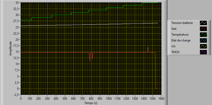

I use 2 BQ25756 chargers in parallel. From time to time, I experience losses of energy and sometimes power peaks that are generated on the output.
the measurements are made by a current sensor for the load current. it globalises the 2 chargers. the capture is sampled every 5s
I have 2 times in this capture where the current of charge are low and I have a current peak.
the mos that separates the battery chargers is open and a 30V protection triggers from time to time. it indicates that at no load, the chargers generate a voltage peak exceeding 30V.

    These waveforms almost look like outliers to me. Can you verify that these currents are actually changing rather than an occasional inaccurate reading? This could maybe be from a shorter time scale on the oscilloscope triggering off of a lower current value.
    It would be helpful to also have a status and flag register reading in the code that occurs every 1s to see if the device reports any changes to operation.
    This would be the expected behavior at no load condition I think. What is the charge voltage of this application? From our FAQ Page:
    • Why are the D4 and D5 blinking alternatively when there is no battery connected?
      Most likely, the charger is going into charge-recharge oscillation. The charger will charge the output capacitors, reach the charge voltage and then terminate. The capacitor voltage will then fall and reach the recharge threshold of the charger. At recharge, the charger will start the process over again.

  • Hi Ludovic,
    I don't see anything unusual reported in the status or fault registers. If the switching noise on the current measurement could be removed, that would be more helpful. I do have another suggestion.
    Can I confirm the inductor on the board? There is 2 on the schematic. Are they both populated on the board? If so, are they the same inductor?
    This image is from the BQ25858-Q1 datasheet, but the L/DCR requirement applies. I took a look at the inductor selection on the board (PA4349.103ANLT), and it looks like it violates the L/DCR. This has been known to cause a little instability. Does moving to a higher DCR inductor help the measurements you are seeing?

    I tested with only one bq25756 active under 10A of load current. The inductance is replaced by a PA2247.103NLT. I always have the same problems but more frequent. The PA2267.103NLT have a Rdcr of 8.6mohm.

    I am having difficulty plotting the data into a waveform. Are there any flags being set in the flag registers?
    I don’t have a detected fault on fault_status, but only the status 1 which changes from 0x80 to 0x00 when it happens.

  • Hello Ludovic,
    Thanks for being patient with me jumping into the thread. I have a few questions to help debug this.
    • Just to make sure, is the data logger fast enough to capture the switching waveforms? Do you see the same behavior with an oscilloscope?
    • Do the chargers have different termination current settings or do the chargers have the same termination current setting?
    • Does the battery have a battery monitor or a battery gauge? Is the battery monitor/gauge turning-off the protection FETs? Is the battery monitor/gauge throwing any flags?

  • Hi Ludovic,
    The switching waveform during the low current event would be helpful to look at. The time scale of 10 ms is not enough to determine what the charger is doing to cause the current abnormalities. I do find it strange that not a single flag from the BQ25756 registers 0x25 to 0x27 though. I assume that the STAT1 and STAT2 pins do not change their state either?
    We recommend that the chargers have different charge termination levels. If the charge termination is set lower on one device, this will prevent both devices from trying to be voltage sources at the same time.
