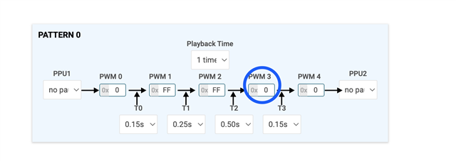

Hi expert,
Customer is doing some preliminary testing on the LP5815 LED driver. When assigning the same engine pattern to two different outputs they am seeing a timing offset of ~15 ms. Specifically at the point circled here (ie output 0 goes to 0 PWM 15 ms before output 2). Is an offset like this expected? What is the reasoning for this? For the application they need to align timing between two different outputs.
Thank you!
McKenna

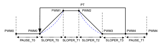

  • Hi McKenna,
    This offset is not expected. Can you help to read the register map value of 4 PATTERNx_SLOPER_TIME(T0,T1,T2,T3) and 2 PATTERNx_PAUSE_TIME(T0, T1)?
    BR,
    Leon

    Hi Leon,
    Please see register details attached!
    McKenna
