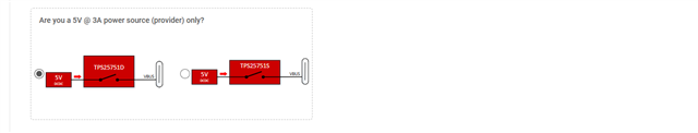

I am using TPS25751 for USB PD application, and now I just want it to be 5V/3A source. I designed a buck LM51772 to output 5V, which connected to TPS25751 PP3.
Is it feasible that I config PP3 to be the source for this application?
It is strange after I config as I described, and I connect it to a cell phone, I measured the output voltage is 0V~3V transient voltage.
How can I locate where the problem is ? Thank you
