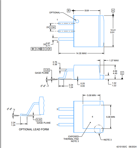

I have a question about the length of the TO-263 package.
There are places where the min/max value is written and places where only the Typ value, max value, and min value are written. Regarding the places where only the Typ value, max value, and min value are written, could you please tell me the min/max value?
Regarding the lead part, the max value of the lead is 2.24mm while the length of the pattern is 2.16mm. In this case, the lead exceeds the pattern. Is this the intended value?
