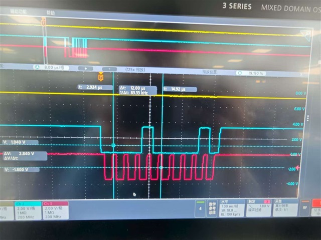

The customer is using BQ7695202 REG to pull up I2C. MCU is using external power supply.
Every time MCU wake up BQ76952 using TS pin, mcu can not communicate with BQ76952 for several times. (The time could last 1~2s, which is much longer than 250ms)
The above picture shows the I2C communication failure. Could you help to preproduce this issue in our EVM and  analysis the reasons?
