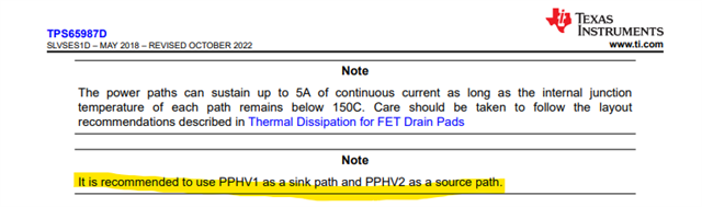

I am using a TPS65987DDH as a power source only device (PP_HV1). For some reason PP1 is never switched ON, no matter what I try in the configuration. I tried with multiple different devices (tablet, smartphone, etc) but I always get the same result.
I have included the pjt file.
