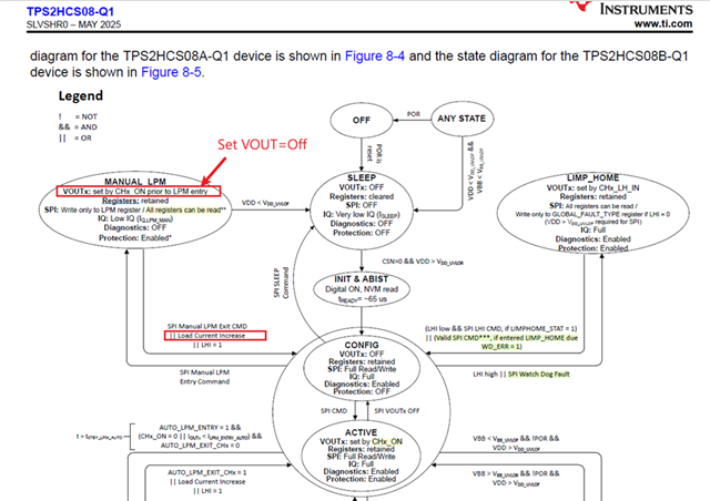

For TPS2HCS08-Q1’s LPM mode, VOUT can be set to Off:
        Set CH1_ON=0h:  CH1 Output set to OFF (FET is OFF)
My question is when set VOUT to Off, does it mean the load current will also be 0? Can it change from LPM to Active through “Load Current Increase”?
