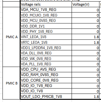

Hi Mike,
I've just done both PMICs power rails measurement, see the measurements:
as you can see most of power rails are 0V, next step I will hook up the scope and check if PMICs are attempting to start up.
We believed that one possible cause for the output zero is the overload condition being met, so we are trying to see if anything could cause that on each rail.
another thing I am not very sure, since we have 2 PMICs in our system, do you think it can cause output zero if mis-communication between 2 PMICs?
or you have other insight ?

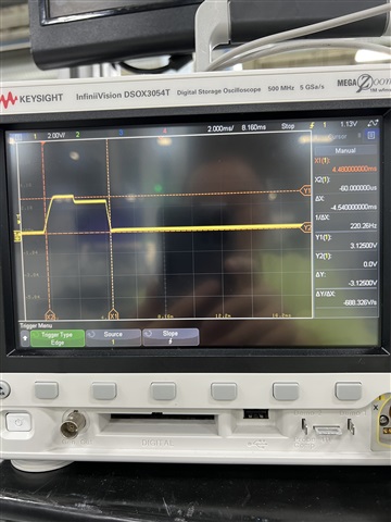

I scoped the PMICs main bucks output, it does attempt to start up, but just one attempt, should it be multiple attempts?
another thing I noticed that on second buck of PMICA, attempt looks over the actual voltage (1.8V), is it correct?
Please see attached picture
