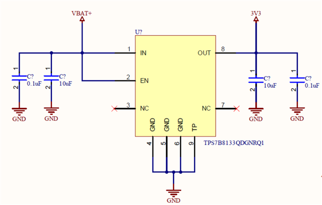

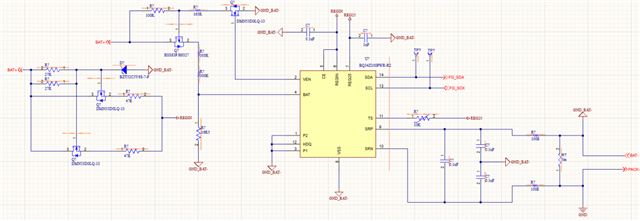

  • Hi Diego,
    Thanks for the feedback.
    could you check the schematics and let me know if i need to add anything else:
    LDO section, VBAT+ is 21 to 15V (5S battery).
    Check, VEN, TS, BAT pins. REGIN is 3.3V. Note: I have added 4.7k pull up on MCU side.
    Looking forward for your review comments!
    Here are my concerns about the schematic.
    1) the TS pin connection is wrong, the pin does not need to be tied to gnd, and the thermistor should be connected to TS and reg 25. See EVM
    2) you need pull ups on i2c lines, they could be off the schematic
    3) on the VEN pin, that is the purpose of the pullup to reg25 and the 1M resistor? These are not necessary to drive the VEN pin.
    EVM schematic below for reference.

    Diego
  • sorry missed your note about the pull ups at the bottom
  • Hi Diego,
    Thanks for your detailed review.
    As you mentioned, TS pin is connected with 10k NTC to REG25 right? No need of 10k resistor with ground? Then I'll DNP it. No need of any additional circuits to be added since i'm not using alert configuration.
    VEN pin is output drive type, it can give high when REGIN is supplied and it can change low when REGIN is not present. no need of pull up and optional 1M pull down?
    Then I'll DNP the Pull up to REG25, Pull down to VEN pin, Pull down to 10K resistor in TS pin. It will solve the connection issues right?
    Need your response accordingly!
    correct, looks good on the schematic
    correct
    sorry, what is the connection issue? I thought we were just reviewing the schematic for errors.
    Diego
