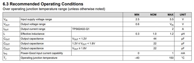

Is the Cout described in the datasheet effective capacitance including derating or rated capacitance without derating?
These are the rated capacitance with the following derating.
(1) Inductor tolerance and current de-rating is anticipated. The effective inductance can vary by +20% and –30%.
(2) Capacitance tolerance and bias voltage de-rating is anticipated. The effective capacitance can vary by +20% and –50%.
(3) This LC combination is the standard value and recommended for most applications.
(4) The minimum COUT of 10 µF does not support an additional feedforward capacitor.
