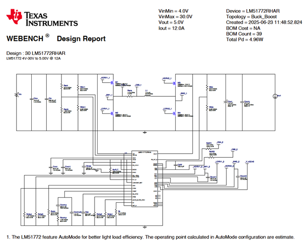

The folllowing is taken from the Webench Design Report

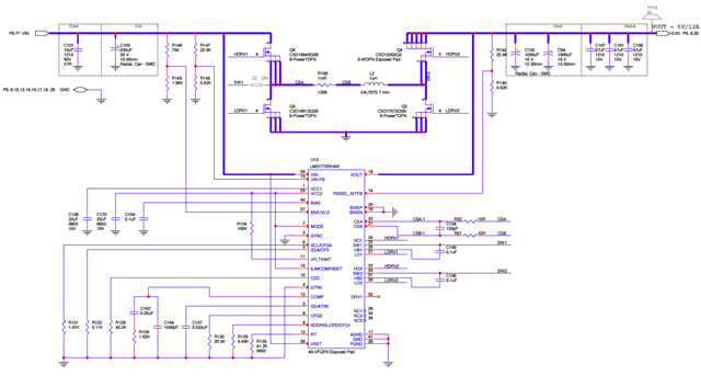

The following is the the schematic that we manufactured.
The 5V output drives a secondary 0.95V power supply using the TI TPSM82816SIER, plus a few peripherals etc. Very small load.
We are using a 12V/7A DC supply to power up the board. However the 5V is not working.

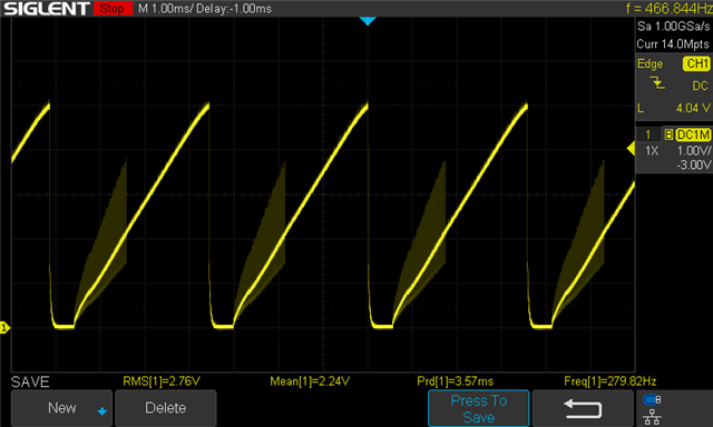

The first issue we noticed was that the Webench Rfbb1 supplied value (1.96K) is too low too enable this device. The manually calculated value show that it should be around 38K. We removed the Rfbb1 (0402) to allow EN_UVLO pin (now 12V) to enable this device. Now the 5V supply does switch on but the output looks like this.
And the input and output caps are overheating. We think the LM51772RHAR maybe current limiting but we can't verify what the current limit should be given the none I2C adaption. From the schematic(s), you will notice that we are only implementing Rsns for sensing. I.e. no Risns.
Rsns = 1mR
Rdiff(s) = 10R, Cdiff = 120pF. From this we can calculate the ton,min = 150ns (Ref. section 7.3.10 Peak Current Sensor in the LM517772 datasheet)
We find that section 7.3.12 Current Monitor/Limiter is unclear given our system design (none I2C).
How can we verify if this supply is current limiting?
What else maybe causing this?

    2) Schematic capture was completely copied from your Webench tool on June 23, 2025 (and yes, we did compare Webench schematic produced from Webench link on product page, and separately from Webench tool itself by specifying part and parameters).
    3) We ordered x5 boards to prepare for client demo in October and since the rest of design is already verified from previous designs, 5V circuitry is the only "new" part.
    4) We received our boards last week and unfortunately 5V supply is not working, at all - problem that we did identify immediately is incorrect lower resistor value in volage divider feeding Enable pin. As of today, September 22, your Webench produces correct value for this resistor, but by the same token generates slightly different values for the rest of this circuitry. Mark has all data captures from June 23rd as an evidence that we did follow your Webench data to the point.
