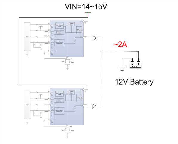

TPS1H100-Q1: Can we use 2pcs TPS1H100-Q1 in parallel for current limitation?
Part Number: TPS1H100-Q1
Hi Expert,
My customer need a 2A current charger solution for 12V battery, the input is about 14~15V, they think TPS1H100-Q1 is suitable for current limitation. Considering the thermal risk, they will use 2pcs TPS1H100-Q1 in parallel for total 2A current charger(set each TPS1H100-Q1 for 1A current limitation), here is their system block diagram, could you please help to check and provide some review suggestions, thanks in advance!
