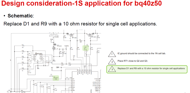

My customer is considering 1S application for BQ40Z50,
Please help to confirm what’s the max resistance for R9? Can we use 18 Ohm for R9?
