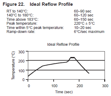

Hi team,

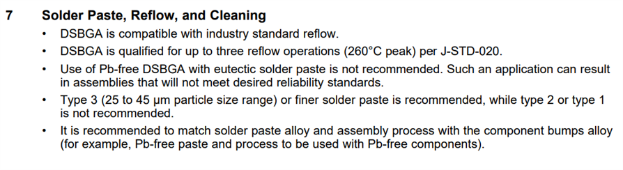

Regarding the profile for LP8758-EA, the diagram below shows ideal conditions. Are there any implementation results under more relaxed conditions?
Specifically, the peak temperature of 225°C is a challenging factor.
Also, it appears the results are under an N₂ environment.
Is an N₂ environment specified as an implementation condition?
Ryu.
