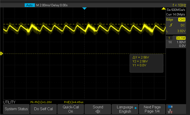

  • Hi Jeff, thank you for your support on this
    I verified the output on BATP and I can see triangular waveform.

  • Hi Ayush,
    Does the triangular waveform peak at slightly above 12.6V?
    Regarding 1, I will send this to TI's gauge team for comment.
    Regarding 2, unfortunately no.  The trickle charge voltage and current values are fixed.
    Jeff
  • The BQ25672, only give 2.5 V for a dead battery, It never give >2.5 volt. The oscilloscope trace is attached with this mail.
  • Hi Ayush,
    There were some BQ25672 ICs that were improperly tested and cannot exit trickle charge. Please send the IC top markings and/or the reel label and I will investigate.
    Jeff

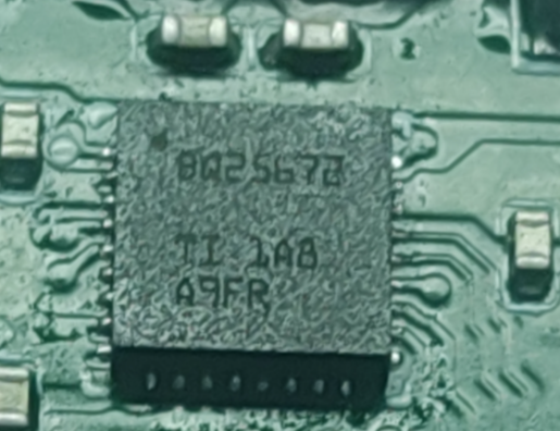

  • Hi Jeff,
    Please find the IC markings in below image
  • Hi Ayush,
    This batch of ICs was tested incorrectly.  Approximately 10% of the batch/reel can get stuck trickle charge when no battery or battery with open pack protector is connected. Otherwise the ICs will work normally.  You can return the ICs referencing "stuck in trickle charge".
    Jeff
