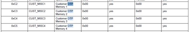

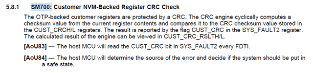

When we implement the SM700 of BQ79606 according to safety manual. We are unable to confirm the relevant address area.
Could you please tell us the exact address range for the OTP-backed customer registers which are protected by a CRC.
Does it refer to only these areas?
