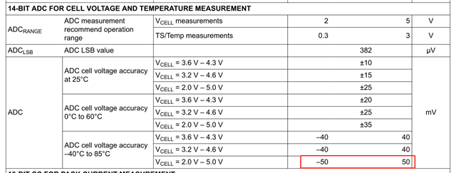

As shown in the figure, this is the specification sheet of BQ76930. The maximum ADC sampling error can reach ±50mV. May I ask how we can improve the ADC sampling accuracy?
