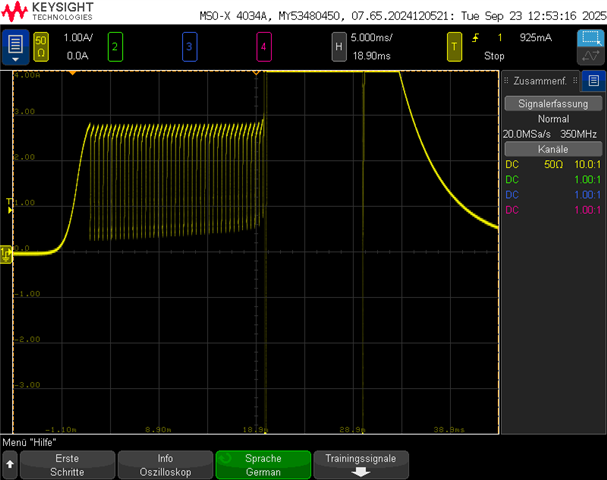

Hello! I need help!
I have 3-chanel switch, based on TPS2490DGS part. 2 channels are ok (gate control shuts off) and on the third one  gate control signal oscillates with 400us if I test short cut protection. Mosfet burns true.What is wong?
Mosfet: 2xSQJQ184E (with back current protection), dv/dt RC 1k/100nF, timer C=2.2nF, Vref resistors - 220k/27k, shunt R=3mR, max.current 16A
Thank you!
