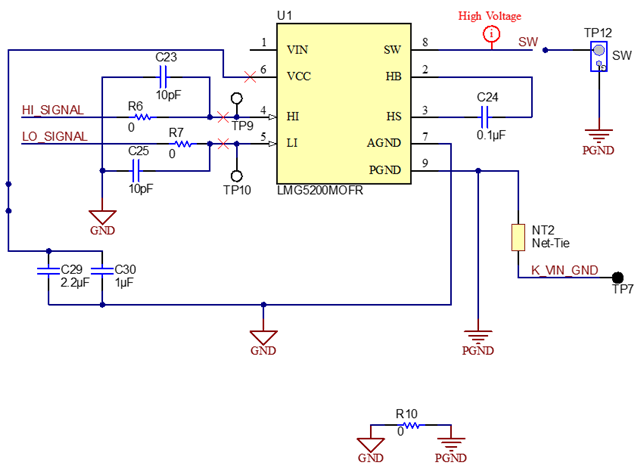

Hi Team,
may we ask you to review this schematic to see if there any issue? thanks for you help and learn from you.
LMG5200.pdf

  • Hi Tommy,
    Please see my comments below:
    Refer to following image:
    • Consider 1uF and 2.2uF caps for the VCC
    • Separate AGND and PGND for better signal integrity.
    • Please refer to the EVM sch and layout Altium files for further reference on this:
    https://www.ti.com/tool/LMG5200EVM-02#design-files
    Subhransu
  • Hi Subhransu,
    got it , thank for your great support.
